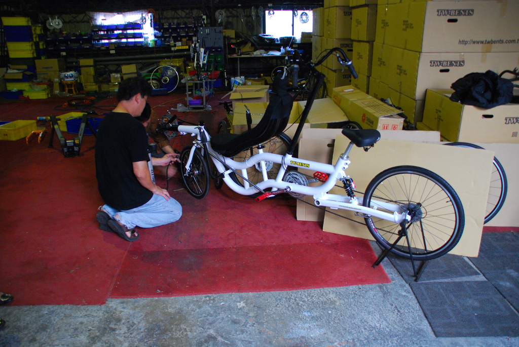

MessageSujet: Re: tandem T W BENTS BT-2 ?   Jeu 13 Oct 2011, 14:48
In situ.

MessageSujet: Re: tandem T W BENTS BT-2 ?   Jeu 13 Oct 2011, 16:50
